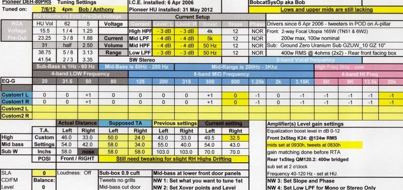

Bobcatsysop Neutral Newbie June 9, 2006 Share June 9, 2006 (edited) Hi Bro, Pioneer DEH-P6850MP has 7-band digital graphic EQ is it? Mine is a P80 and have 16-band EQ and I'm still a newbie.. not ice guru. I did have some ICE gurus at Nasi Padang meetup that helped me to tune my EQ and TA. Mine is tuned for audiophile vocals and instruments. Click here for my updated tuning setup for my P80. Edited June 9, 2006 by Bobcatsysop Link to post Share on other sites More sharing options...
Sturtles 6th Gear June 10, 2006 Share June 10, 2006 Hi bro, I'm an ICE idiot and I saw your EQ settings, and noticed the fader is pushed to the rear, is it because your rear is powered by HU only, without the amp? Also, what does the X-over Hz affect? isn't it better to have all the frequencies than to restrict to above 125 for the rear and 63 for the fronts? Also, the slp decibels, are there any reasons you set it to 12? Cuz I was thinking pass is better isn't it? Thanks for reading :) Link to post Share on other sites More sharing options...
Bobcatsysop Neutral Newbie June 10, 2006 Share June 10, 2006 Hi Bro, Mine is a passive setup using xovers provided by Focal. FYI, I am still a newbie in ICE.. <> I think you may have misread it. I had moved 64% to the front leaving behind 36% for the rear not the other way round. Yes.. my rear is powered by HU only without the amp. <> I am still fidling around with these gain settings. So far, this settings appear to be OK to me but not to others. Normally, when I am driving alone, I will fade 100% fully to the front for better effect that I liked most. It's personal preference. <> Tune by ear, listening. 12% for both front and rear appears fine while the SW 18%. Again, what I said here may not make sense to a lot of ICE gurus coz I am still learning. Link to post Share on other sites More sharing options...

Bluesbro Neutral Newbie June 16, 2006 Author Share June 16, 2006 Hi .. thanks for the info .. saw that you shifted the sound F/R: 25 .. meaning the rear speakers got no sound ? Just wanna check what type of music are your current eq settings meant for ... Link to post Share on other sites More sharing options...
Bobcatsysop Neutral Newbie June 16, 2006 Share June 16, 2006 (edited) Hi Bro, Yesterday afternoon, I tried it out for one day to fade it 100% to the front to see the full effect of the changes done. Today, I had moved the TA for my soundstage a little (seemed better than yesterday) and moved back to fade only 64% to the front leaving behind 34% for the rear. That 34% rear provides my car cabin the most ideal surround sound ambience. Oh.. my EQ was set for vocals (like Cai Qin) audiophile CDs also instrumental. I had just updated my tuning setting Edited June 16, 2006 by Bobcatsysop Link to post Share on other sites More sharing options...
