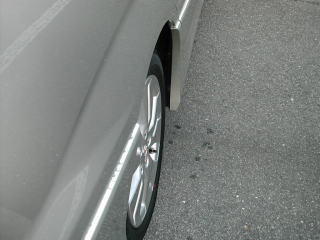

Wire Neutral Newbie June 12, 2005 Author Share June 12, 2005 WTS installed.....not on my ride though. Link to post Share on other sites More sharing options...
Wire Neutral Newbie June 12, 2005 Author Share June 12, 2005 Before and After Link to post Share on other sites More sharing options...
Wire Neutral Newbie June 12, 2005 Author Share June 12, 2005 More before and after... Link to post Share on other sites More sharing options...

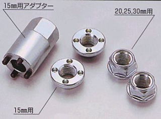

EventH 1st Gear June 12, 2005 Share June 12, 2005 (edited) Even those with the builtin extension bolts are not safe?[sweatdrop] http://www.checkerflag.co.jp/widespacer.html The narrowest is 15mm ... with lowered car, wheels will probably kenna the fenders. For the 15mm there is even a special nut..see below relax lar you all so serious Edited June 12, 2005 by EventH ↡ Advertisement Link to post Share on other sites More sharing options...
