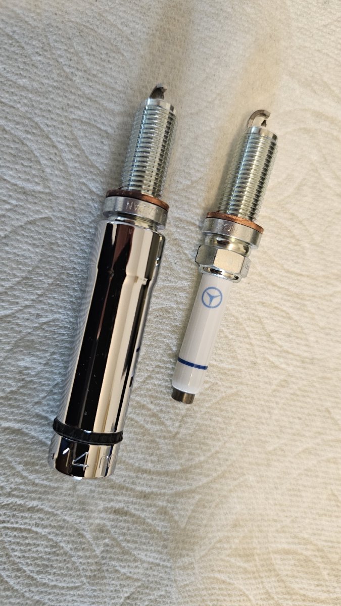

Gnahp Turbocharged July 14, 2024 Share July 14, 2024 I changed the spark plugs of my wife's car recently I thought I know it all but still learnt a few new things along the way 1. spark plug indexing (google if you want to know more) I read about spark plug indexing many years ago, I thought that is for top fuel/dragsters, racing cars, never know my wife's car need to use the correct spark plug and correct torque when installing, to ensure the opening end of the electrode facing a certain direction as designed, aka spark plug indexing 2. multi spark not the same as twin spark, multi spark ignition coil fires a single spark plug multiple times in succession (up to 5 times) during lean burn cycle, to increase the chances of igniting ultra lean air fuel mixture. In other words, the spark plug wears faster than normal ignition system which fires once in the beginning of power stroke the new plugs are pre-gapped but I kiasi, I measure them again, all spot on at 0.70mm I also mark the new plug with marker pen, so that I can tell which way the opening end of the electrode is facing after installed. The position of the ground electrode is not random, you can see they all aligned perfectly with the hex corner of the plug (where I marked), I believe the thread also not cut randomly, there are some interesting engineering elements in this old and simple automotive part my spark plug socket size in my tool box is getting smaller and smaller over the years, I don't have this size (14mm), got to order a new one. Oh yes, look at the washer, it is solid copper, not the usual folded metal crush washer, part of the design to ensure the spark plug is indexed when you apply the correct torque. They don't crush when I torqued it, very weird feeling but I have to trust the engineers who designed it also, factory said never use anti seize on the thread as the thread is plated with some tok kong plating, new to me too I let the engine cool down over night before I remove the old plugs, this is controversial, some say don't need blew lots of fine sands from the spark plug well/hole, if you skip this part, those abrasive fine sands will drop into your cylinder when you pull out the spark plug I marked the old spark plug before removing, we bought the car new, I wanted to check the orientation of the plug indexing done in the factory so that I can have a reference point when I install the new plug by factory recommended torque (23Nm) all the new plugs facing the exact direction like those from the factory I also measure the gap of the old plugs, they are 0.75mm 0.74mm 0.76mm 0.75mm new plug is 0.70mm negligible wear at 102,000km those are iridium centre electrode, platinum side electrode plugs, suppose to last 150,000km but I follow the factory recommendation to change at 100,000km, I felt cheated, should change them at 150,000km 😁 engine is a little bit smoother after plug change but that could be placebo effect 4 1 Link to post Share on other sites More sharing options...
