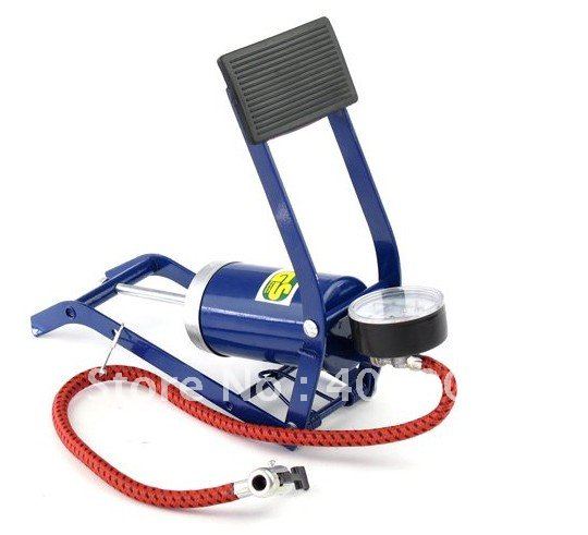

TVT Supercharged August 12, 2014 Share August 12, 2014 You should buy and hand pump instead of leg pump. Is this pump (either use hand or leg) the same pump used to inflate bicycle tyres ?? Like these 2 : Link to post Share on other sites More sharing options...
Kangadrool Supersonic August 12, 2014 Share August 12, 2014 yes, but recommend to use the hand one. Is this pump (either use hand or leg) the same pump used to inflate bicycle tyres ?? Like these 2 : Link to post Share on other sites More sharing options...
