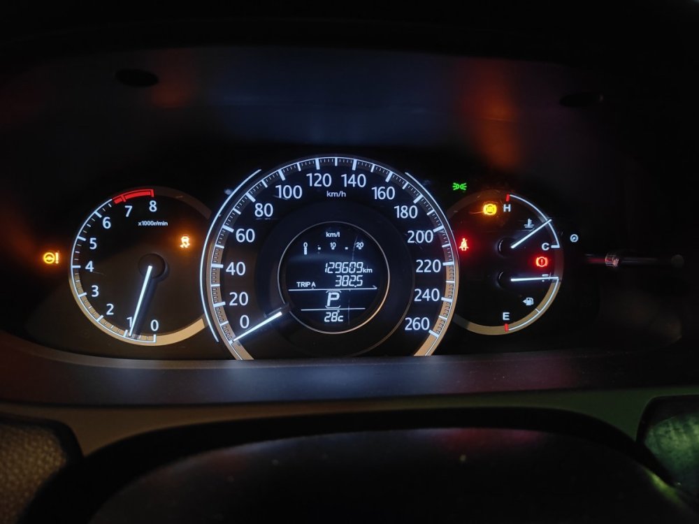

Lala81 Hypersonic September 4, 2024 Share September 4, 2024 (edited) Not a citroen. 9 year old Honda with 4+ months to go. But experienced ABS + parking brake + traction control light + power steering light on while driving home from dinner. Based on reddit accord forum, it's likely either wheel speed sensor vs ABS modulator for the first 3. Braking feels fine to me. Of course didn't try to activate my ABS. Edited September 4, 2024 by Lala81 1 Link to post Share on other sites More sharing options...
Lala81 Hypersonic September 4, 2024 Share September 4, 2024 Basically even if I go diagnose to me, it's either scrap early or just keep going as long as can tahan. 1 Link to post Share on other sites More sharing options...
Gnahp Turbocharged September 4, 2024 Share September 4, 2024 when my wife's previous car wheel speed sensor up lorry the car threw a lot of error messages basically all systems that require the signal from the wheel speed sensor will quit working ABS, cruise control, traction control, ESP, etc car drove fine, we drove it for a week or two before I replaced the wheel speed sensor it felt a bit scary in the beginning because no ABS but when I think back last time, all our cars no ABS, traction control etc and we were younger and more reckless too just drive sensibly 1 Link to post Share on other sites More sharing options...

Lala81 Hypersonic September 4, 2024 Share September 4, 2024 Lights disappeared shortly after driving today. Likely some loose or corroded connection? 1 Link to post Share on other sites More sharing options...
Gnahp Turbocharged September 5, 2024 Share September 5, 2024 On 9/5/2024 at 7:46 AM, Lala81 said: Lights disappeared shortly after driving today. Likely some loose or corroded connection? intermittent fault could be many reasons, from accumulation of ferrous dust on the magnet to faulty ABS unit but likely will come back again if you are lucky, got slim chance it will self cured 😁 Link to post Share on other sites More sharing options...
Lala81 Hypersonic September 5, 2024 Share September 5, 2024 On 9/5/2024 at 9:46 AM, Gnahp said: intermittent fault could be many reasons, from accumulation of ferrous dust on the magnet to faulty ABS unit but likely will come back again if you are lucky, got slim chance it will self cured 😁 I hardly use ABS unless I e-brake when delayed reaction to red light. So no big deal. Just drive it like a 70-80 year old driving an old car. 1 Link to post Share on other sites More sharing options...
Gnahp Turbocharged September 5, 2024 Share September 5, 2024 On 9/5/2024 at 9:58 AM, Lala81 said: I hardly use ABS unless I e-brake when delayed reaction to red light. So no big deal. Just drive it like a 70-80 year old driving an old car. it is like seat belt, airbag, fire extinguisher and insurance 😁 I only started driving cars with ABS from 2012 drove cars with no ABS for more than 20 years prior to that never lock the wheels even once, with or without ABS (deliberate ABS testing no count) 2 1 Link to post Share on other sites More sharing options...
