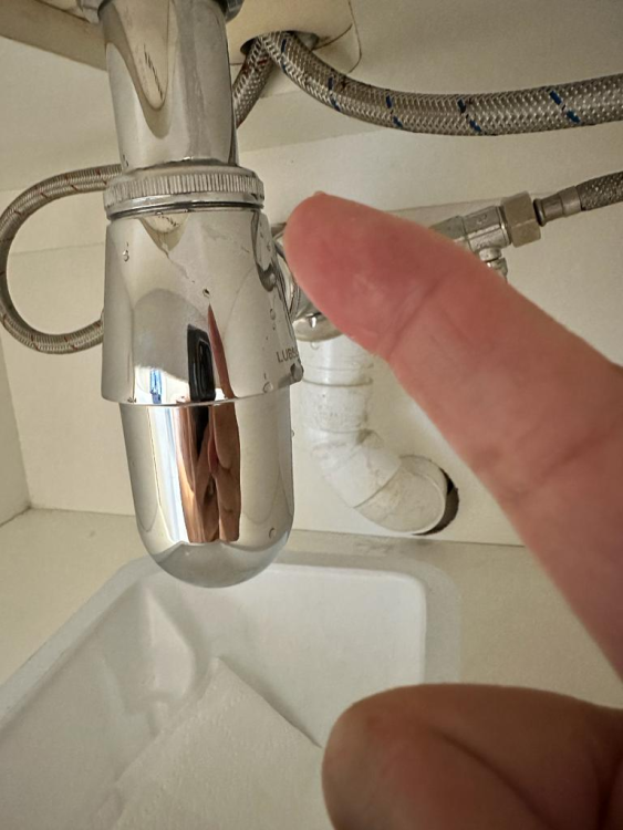

therock Supersonic November 4, 2023 Share November 4, 2023 Bros, this sink keeping having a very gentle leak that befuddles my plumber.. It seems to be leaking from this part, they add tape, remove tape but it's still leaking.. Any ideas? Thanks Link to post Share on other sites More sharing options...

Volvobrick Supersonic November 4, 2023 Share November 4, 2023 On 11/4/2023 at 5:31 PM, therock said: Bros, this sink keeping having a very gentle leak that befuddles my plumber.. It seems to be leaking from this part, they add tape, remove tape but it's still leaking.. Any ideas? Thanks Maybe there is a silicon gasket and white tape won't help. Link to post Share on other sites More sharing options...

therock Supersonic November 4, 2023 Share November 4, 2023 On 11/4/2023 at 6:05 PM, Volvobrick said: Maybe there is a silicon gasket and white tape won't help. As in - add a gasket inside? Link to post Share on other sites More sharing options...
Kb27 Supersonic November 4, 2023 Share November 4, 2023 On 11/4/2023 at 5:31 PM, therock said: Bros, this sink keeping having a very gentle leak that befuddles my plumber.. It seems to be leaking from this part, they add tape, remove tape but it's still leaking.. Any ideas? Thanks there is usually a gasket there. it's flat, when you screw it down, the gasket keeps it waterproof. if it's broken or sealing properly, then it leaks. ptfe tape doesn't help much in that situation. many people don't know ptfe tape is a lubricant, the actual sealing is by the gasket. but strange that your plumber doesn't know. 2 Link to post Share on other sites More sharing options...
Kb27 Supersonic November 4, 2023 Share November 4, 2023 (edited) On 11/4/2023 at 6:35 PM, therock said: As in - add a gasket inside? A new plastic one cost only a few bucks. They all come with sealing gaskets. The black rings are the gaskets: Edited November 4, 2023 by Kb27 1 Link to post Share on other sites More sharing options...

therock Supersonic November 4, 2023 Share November 4, 2023 (edited) On 11/4/2023 at 6:44 PM, Kb27 said: there is usually a gasket there. it's flat, when you screw it down, the gasket keeps it waterproof. if it's broken or sealing properly, then it leaks. ptfe tape doesn't help much in that situation. many people don't know ptfe tape is a lubricant, the actual sealing is by the gasket. but strange that your plumber doesn't know. Thanks strange that part is brand new hmm can you use a plastic cup with the metal top? Edited November 4, 2023 by therock Link to post Share on other sites More sharing options...
Dafansu Turbocharged November 4, 2023 Share November 4, 2023 On 11/4/2023 at 5:31 PM, therock said: Bros, this sink keeping having a very gentle leak that befuddles my plumber.. It seems to be leaking from this part, they add tape, remove tape but it's still leaking.. Any ideas? Thanks just change to plastic one, the material you currently using not easy to fix leak. 1 Link to post Share on other sites More sharing options...
Kb27 Supersonic November 4, 2023 Share November 4, 2023 On 11/4/2023 at 7:13 PM, therock said: Thanks strange that part is brand new hmm can you use a plastic cup with the metal top? The screw-on "cap" simply tightened the 2 parts together, onto the gasket, forcing a waterproof joint. As I mentioned, you don't need ptfe tape, but just the gasket. For brand new, sometimes have manufacturing defect. If you can find a correct size gasket, you can replace it. Otherwise, it's easier to buy a new bottle trap at the shop or online. 1 Link to post Share on other sites More sharing options...
Mkl22 Supersonic November 4, 2023 Share November 4, 2023 On 11/4/2023 at 6:44 PM, Kb27 said: there is usually a gasket there. it's flat, when you screw it down, the gasket keeps it waterproof. if it's broken or sealing properly, then it leaks. ptfe tape doesn't help much in that situation. many people don't know ptfe tape is a lubricant, the actual sealing is by the gasket. but strange that your plumber doesn't know. Plumber doesn’t know means plumber fail big time. Next plumber please. probably need to remove and realign the gasket seal. But ptfe tape is a seal. Just that when used with a rubber seal it causes more harm than it solves and the surface will then not be flat to press against the rubber gasket. With only metal it does seal well Link to post Share on other sites More sharing options...
Kb27 Supersonic November 4, 2023 Share November 4, 2023 (edited) On 11/4/2023 at 8:06 PM, Mkl22 said: Plumber doesn’t know means plumber fail big time. Next plumber please. probably need to remove and realign the gasket seal. But ptfe tape is a seal. Just that when used with a rubber seal it causes more harm than it solves and the surface will then not be flat to press against the rubber gasket. With only metal it does seal well I have tried with ptfe tape on a flat non-tapered thread, Without a gasket, it will leak, no matter how hard you tried to tighten it. ptfe tape is primarily a lubricant. If used with tapered thread, it will form a seal. but most people will look at the white tape and say "hey, that's a seal, that's why it don't leak" https://en.wikipedia.org/wiki/Thread_seal_tape "Thread seal tape is appropriate for use on tapered threads, where the sealing force is a wedge action. Parallel threads may not seal effectively with or without tape, as they are intended to be sealed by a gasket." Edited November 4, 2023 by Kb27 1 Link to post Share on other sites More sharing options...
therock Supersonic November 4, 2023 Share November 4, 2023 On 11/4/2023 at 7:33 PM, Kb27 said: The screw-on "cap" simply tightened the 2 parts together, onto the gasket, forcing a waterproof joint. As I mentioned, you don't need ptfe tape, but just the gasket. For brand new, sometimes have manufacturing defect. If you can find a correct size gasket, you can replace it. Otherwise, it's easier to buy a new bottle trap at the shop or online. So I can tell my family to stop using that sink, unscrew it and bring it to a hardware store tomorrow? I'll try tomorrow at Clementi, there's a nice one near Ave 2, near the Halal Chicken Rice.. Link to post Share on other sites More sharing options...
Kb27 Supersonic November 4, 2023 Share November 4, 2023 On 11/4/2023 at 8:41 PM, therock said: So I can tell my family to stop using that sink, unscrew it and bring it to a hardware store tomorrow? I'll try tomorrow at Clementi, there's a nice one near Ave 2, near the Halal Chicken Rice.. Take note, the bottle trap has 2 sizes. If it's used with the wash basin, it's the smaller one. The kitchen sink usually use the bigger one. ↡ Advertisement 3 Link to post Share on other sites More sharing options...
