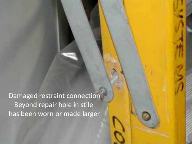

Carbon82 Moderator September 11, 2020 Share September 11, 2020 The very first thing on the safety checklist by Workplace Safety and Health Council (under MOM) is to check if the ladder is of sound construction, defect-free and using suitable material (e.g. fiberglass ladder for electrical work). The very same thing as before driving a car, we have to check that the car is ok (e.g. no bald tyre, working lighting system, etc.). But many take things for granted and thus accident do occurs on and off. Aluminium is light and relatively cheap, thus widely used for ladder construction (including its rivet), BUT at the same time they are soft and subjected to corrosion under humid and corrosive environment (most of us keep our household ladder in store room or outside our house, both are humid environment in relative term). So it would be good to just take a half a minute to check our ladder thoroughly before each use. Some common defects to look out for are: If you noted any form of structural defects, e.g. missing rivet, deformed step or support structure, it is time to get a new one. Think about it this way: your life worth much more than $50 - $100 right? Why bet your safety on something this cheap? ↡ Advertisement 13 Link to post Share on other sites More sharing options...
