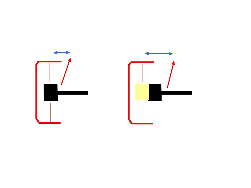

carloverguy2017 5th Gear October 1, 2017 Share October 1, 2017 I dont know about you guys, but here is my concern about wheel spacers. It is structurely unsound. In my exagerated diagram, you will look a the blue arrow and notice that the shock absorber and support to the chassis is totally stressed 1 Link to post Share on other sites More sharing options...

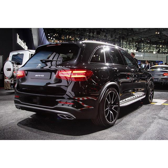

Vratenza Supersonic October 1, 2017 Author Share October 1, 2017 On 10/1/2017 at 6:32 AM, carloverguy2017 said: I dont know about you guys, but here is my concern about wheel spacers. It is structurely unsound. In my exagerated diagram, you will look a the blue arrow and notice that the shock absorber and support to the chassis is totally stressed Make sure your car's suspension is designed to take the additional stress: GLC 250 19inch non-staggered GLC 43 AMG 21inch staggered See how much offset the 21inch staggered rear pushed the rear wheels out that it required a flared fender to maintain the flush look. That additional offset along with heavier 21 inch rim and tire weight is going to stress the suspension components much more than stock 19 inch on 25mm spacers. 1 Link to post Share on other sites More sharing options...
Ake109 6th Gear October 5, 2017 Share October 5, 2017 On 10/1/2017 at 10:20 AM, Vratenza said: Make sure your car's suspension is designed to take the additional stress: GLC 250 19inch non-staggered GLC 43 AMG 21inch staggered But I would think that a GLC43 has a very different suspension setup compared to a GLC250. Link to post Share on other sites More sharing options...
Vratenza Supersonic October 5, 2017 Author Share October 5, 2017 Yes, did consider that in my research as well.......from what I know, it's the same, especially GLCs that are specced with the optional AMG Line which includes the AMG sports suspension (firmer and slight shorter metal springs with firmer shocks). The factory parts numbers are the same. Unless you are talking about the optional Air Suspension which is tuned differently between a GLC 43 vs GLC 250 (if optioned) On 10/5/2017 at 5:59 AM, Ake109 said: But I would think that a GLC43 has a very different suspension setup compared to a GLC250. Link to post Share on other sites More sharing options...

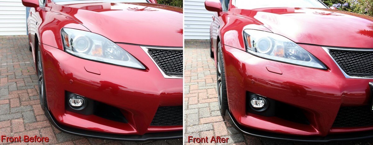

TheresaDavez Neutral Newbie February 22, 2021 Share February 22, 2021 Nice work! or maybe 35mm spacers to make it more flush with the fender will have a better look. I had 20mm wheel spacers(from bonoss) for front and rear on my Lexus IS F. The back of these grooves design is quite unique, they called it"active cooling" grooves, for it uses the rotation of the wheel spacers to make the external cold airflow efficiently and continuously inside the wheel spacers to take away the heat. I have to say, wider stance really makes him into a new look! ↡ Advertisement 1 Link to post Share on other sites More sharing options...
