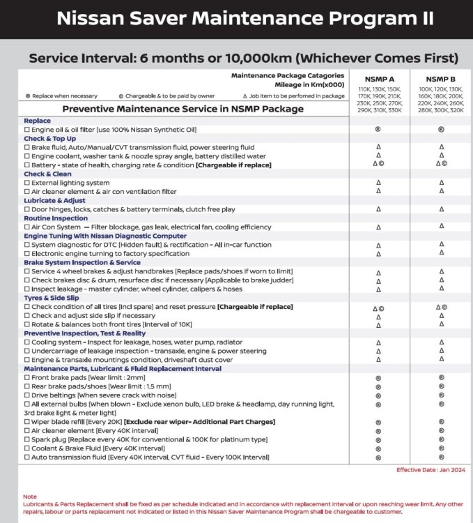

Hoamchu 2nd Gear October 14, 2024 Share October 14, 2024 Hi Anyone interested in taking over Nissan Saver Maintenance Package? Left with 3 services (NSMP Ax2, NSMP Bx1) and valid until May 22, 2026, selling cheap @ $400. Thank you. Link to post Share on other sites More sharing options...
Mkl22 Supersonic October 14, 2024 Share October 14, 2024 On 10/14/2024 at 10:10 AM, Hoamchu said: Hi Anyone interested in taking over Nissan Saver Maintenance Package? Left with 3 services (NSMP Ax2, NSMP Bx1) and valid until May 22, 2026, selling cheap @ $400. Thank you. wah a challenging spot the difference between A and B... 😁 Link to post Share on other sites More sharing options...
Rayleigh 6th Gear October 14, 2024 Share October 14, 2024 (edited) On 10/14/2024 at 11:56 AM, Mkl22 said: wah a challenging spot the difference between A and B... 😁 Deleted. Edited October 14, 2024 by Rayleigh Link to post Share on other sites More sharing options...
