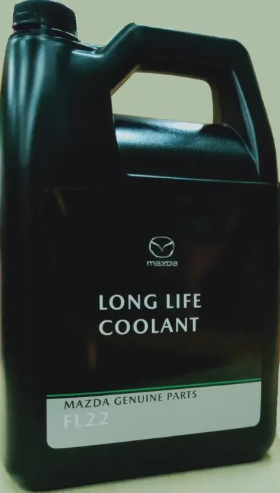

boonhat_91 6th Gear July 26, 2024 Share July 26, 2024 Is it ok to top up original coolant if I cannot 100% ascertain what coolant is in my car? If following the maintenance schedule from mazda, 100k servicing supposed to replace coolant. My (secondhand) car did 100k servicing at 76k mileage according to AD, so is it safe to assume that the coolant was replaced then, and with the original mazda FL22 coolant? I want to top up the reservoir a bit, can I just buy the mazda FL22 and pour in? Worst case scenario, if the coolant in my car is some OEM or aftermarket one, what damage could I expect? Link to post Share on other sites More sharing options...
Beregond Supersonic July 26, 2024 Share July 26, 2024 On 7/26/2024 at 11:03 AM, boonhat_91 said: Is it ok to top up original coolant if I cannot 100% ascertain what coolant is in my car? If following the maintenance schedule from mazda, 100k servicing supposed to replace coolant. My (secondhand) car did 100k servicing at 76k mileage according to AD, so is it safe to assume that the coolant was replaced then, and with the original mazda FL22 coolant? I want to top up the reservoir a bit, can I just buy the mazda FL22 and pour in? Worst case scenario, if the coolant in my car is some OEM or aftermarket one, what damage could I expect? Can mix . Dun worry. But make sure use same colour. And check your coolant make sure its not those concentrate tyre. Best is buy pre mix ready and top up If u see the level like 5mm less then max. And u really buay ta han. Just top up with pain 💧. But if your coolant level keep going down. And u need top up every week. Mean something wrong already. By right dun need to do any top up . Link to post Share on other sites More sharing options...
Jamesc Hypersonic July 26, 2024 Share July 26, 2024 Not safe to assume coolant changed during service unless you see bill saying coolant changed. Top up a bit just just use distilled water from supermarket. Full change coolant use this. On 7/26/2024 at 11:03 AM, boonhat_91 said: Is it ok to top up original coolant if I cannot 100% ascertain what coolant is in my car? If following the maintenance schedule from mazda, 100k servicing supposed to replace coolant. My (secondhand) car did 100k servicing at 76k mileage according to AD, so is it safe to assume that the coolant was replaced then, and with the original mazda FL22 coolant? I want to top up the reservoir a bit, can I just buy the mazda FL22 and pour in? Worst case scenario, if the coolant in my car is some OEM or aftermarket one, what damage could I expect? Link to post Share on other sites More sharing options...
