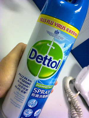

Darthrevan Supercharged February 13, 2012 Share February 13, 2012 use dettol spray..switch on the heater and spray..leave heater on for few minutes..not only gets rid of smell but its a disinfectant as well Link to post Share on other sites More sharing options...
