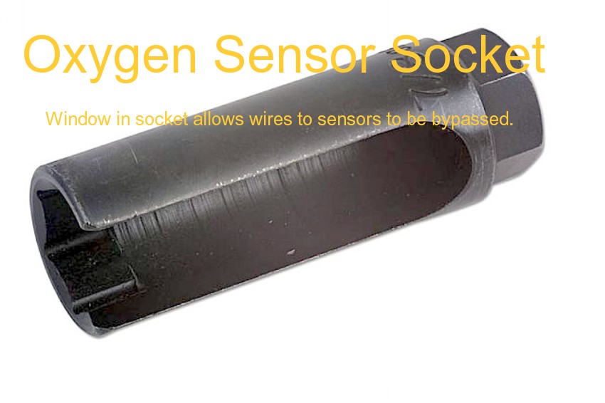

Yeobh 4th Gear May 14, 2011 Share May 14, 2011 (edited) You will need to have the right tools to remove and install the sensor. Due to high exhaust temp the unit is almost "weld" to the exhaust pipe. Cleaning the threads it a must to ensure the new unit seats in properly without any exhaust leakage. Edited May 14, 2011 by Yeobh Link to post Share on other sites More sharing options...
