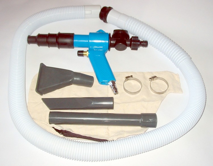

Yeobh 4th Gear May 12, 2011 Share May 12, 2011 (edited) This engine bay vortex washing gun is powered by compressed air. The amount of water and air can be manually controlled. After washing the water is shut off and the gun is used a a high volume air blower. Edited May 12, 2011 by Yeobh Link to post Share on other sites More sharing options...
