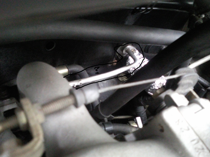

Stanchiam 1st Gear December 31, 2010 Share December 31, 2010 I have just done aircon pipe insulation wrap using kaiflex insulation (Kaiflex ST) http://www.kaimann.de/en/products/product.html?id=381276.Its Max. Medium temperature: + 105°C, MIn. Medium temperature: -50°CAfter the DIY, feel my aircon become colder much faster and when I off it, the cold air last much longer.Previously, when I off my aircon, the cold air disappear after less then 30s, now after 3-5m, still feel it is a little cold.Cost only $2 for the tube and $2 for the cable tire and aluminum foilFeel very satisfied with the effect.BEFOREAfter ↡ Advertisement Link to post Share on other sites More sharing options...

Stanchiam 1st Gear December 31, 2010 Author Share December 31, 2010 (edited) $2 for the tube? i spend $10 for only a meter!... where you buy such a gd deal? yeah, it's really useful. though i don't feel my air con any cooler or stuff, at least i know the vapour droplets don't go into my sensers. not to forget... the back breaking session... got it at aircon material in McPherson road 2m long for $1.90 I used up only 1m, still left 1m hmm...i dont feel back breaking, took me less then 15mins mine I can feel the air become cooler much faster, instant instead of waiting for 5-10s before the DIY Edited December 31, 2010 by Stanchiam Link to post Share on other sites More sharing options...

Byond 1st Gear December 31, 2010 Share December 31, 2010 (edited) turn on ur air con for 5 mins let it run then off the air con open ur bonnet the tubing that have water droplets on it wrap it such wrap will help (abit) to let ur air con cool the cabin faster as the wrap will help to insulate the cold piping against the engine heat. For a more effective cooling system rem to change ur air con filter too... this change will help to prolong the life of your air con compressor... Edited December 31, 2010 by Byond Link to post Share on other sites More sharing options...

Ender Hypersonic December 31, 2010 Share December 31, 2010 I think you wrapped the metal tube that is cold after you on the air-con for a few minutes... Anyway I got Armaflex for around $2 per tube too.. $10 per meter is chopped carrot.. Link to post Share on other sites More sharing options...
Mkl22 Supersonic December 31, 2010 Share December 31, 2010 wrapping the tube does nothing for the coldness of the a/c. those who know the principles of how the a/c works would know this. Link to post Share on other sites More sharing options...

Ender Hypersonic December 31, 2010 Share December 31, 2010 (edited) wrapping the tube does nothing for the coldness of the a/c. those who know the principles of how the a/c works would know this. Yes it does nothing to coldness, as that is control by knobs or button setting for temperature or thermostat. What the insulating tube does is reduces heat loss during coolant transmission. Basically you want more of heat exchange to occur at the coil where the wind blows into the cabin, rather than loose some heat at the engine bay. This should translate to the lesser energy used to achieve the same cooling load. Edited December 31, 2010 by Ender Link to post Share on other sites More sharing options...
Jamesc Hypersonic December 31, 2010 Share December 31, 2010 Yes it does nothing to coldness, as that is control by knobs or button setting for temperature or thermostat. What the insulating tube does is reduces heat loss during coolant transmission. Basically you want more of heat exchange to occur at the coil where the wind blows into the cabin, rather than loose some heat at the engine bay. This should translate to the lesser energy used to achieve the same cooling load. Thank you! So many people say shouldn't wrap air con tube or it doesn't work. Haha they are wrong and they can still write other people dun know how A/C works! Link to post Share on other sites More sharing options...
Ender Hypersonic December 31, 2010 Share December 31, 2010 Thank you! So many people say shouldn't wrap air con tube or it doesn't work. Haha they are wrong and they can still write other people dun know how A/C works! Actually I read somewhere Air con wrapping will trapped the condense water, and this may corrode the piping.. How serious or true is that? I don't know. Link to post Share on other sites More sharing options...
