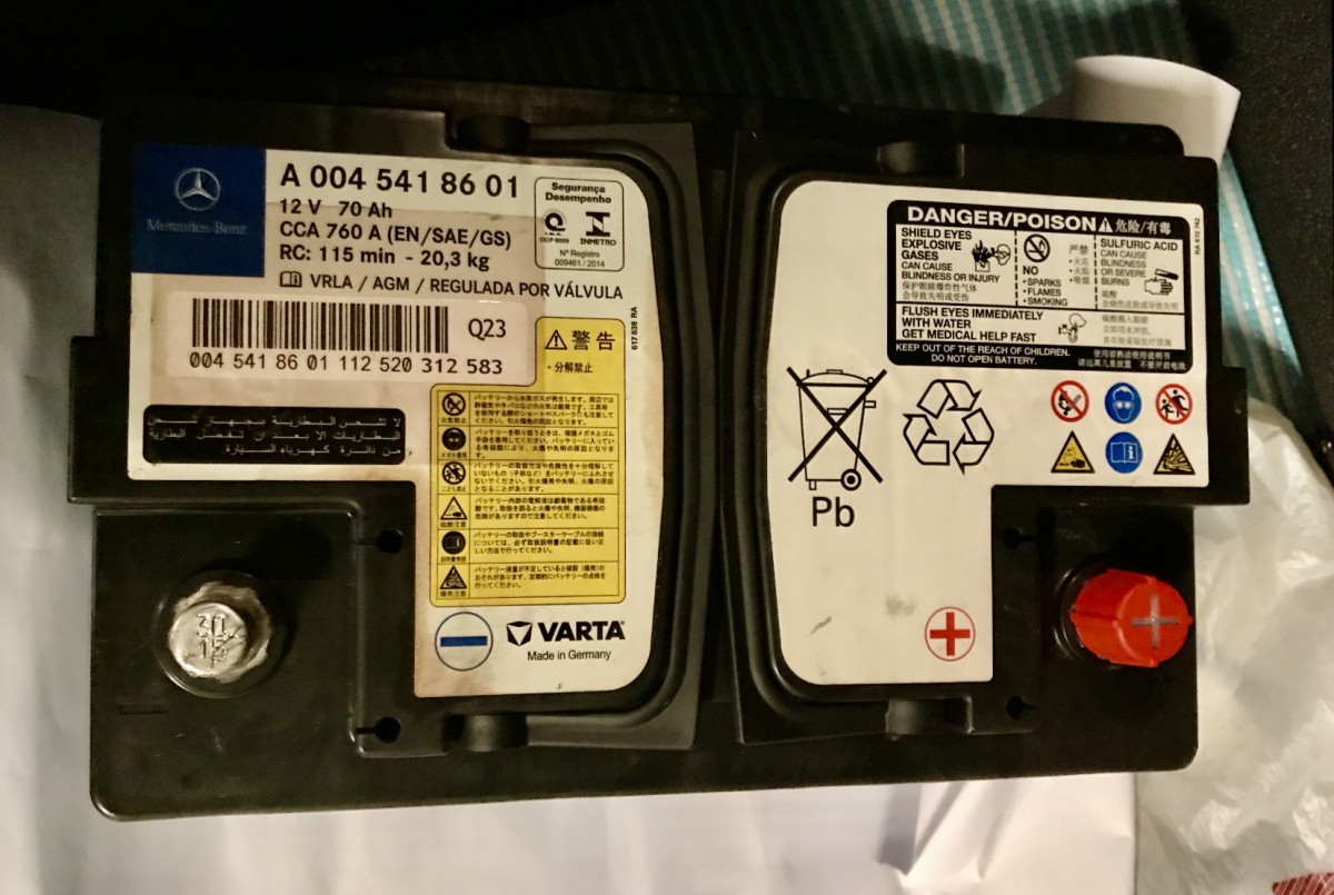

Bezbee 5th Gear June 19, 2020 Share June 19, 2020 I think these days due to the fancy electronic gadgets, they drain up the battery quite fast. Even thou I change original battery at AD, mine also only last 1.5years only. 1-way to office is 19km, is it enough to charge the battery ? My car is turning 5years in Sep, already the 3rd battery (just replaced Feb). Even thou 90% of time it is parked in sheltered carpark in MSCP & office. No fancy add-ons in my car … only 1 front camera recording when car is powered. 1 Link to post Share on other sites More sharing options...

Bezbee 5th Gear June 19, 2020 Share June 19, 2020 On 6/19/2020 at 8:49 AM, Beregond said: what brand battery u use? i feel branded battery like amaron varta really last longer then those cheap no branded 1. Expand No wor.. my also Verta (made in German) some more ... also last about 2years 1 1 Link to post Share on other sites More sharing options...

Beregond Supersonic June 19, 2020 Share June 19, 2020 On 6/19/2020 at 8:59 AM, Bezbee said: No wor.. my also Verta (made in German) some more ... also last about 2years Expand what car u driving. 2 years for this is quite fast. those benz and BM, orginal battery last 3-4 years easily 1.( normally ) 1 Link to post Share on other sites More sharing options...

inlinesix Hypersonic June 19, 2020 Share June 19, 2020 On 6/19/2020 at 9:13 AM, Bezbee said: Bo bian, car under warranty … any parts even battery change outside may give them reason to void the warranty (service advisor say one) … very chao hor …. Expand My 1st replacement was claimed under warranty. I asked AD to check its health as i know my car battery will uplorry by Year 2. I am on the 3rd battery for 6 year old car. WS advised to use AGM battery as it will last longer. See how 1st. My guess engine bay heat kills battery. Link to post Share on other sites More sharing options...
inlinesix Hypersonic June 19, 2020 Share June 19, 2020 On 6/19/2020 at 9:14 AM, Beregond said: what car u driving. 2 years for this is quite fast. those benz and BM, orginal battery last 3-4 years easily 1.( normally ) Expand That is likely to be battery in boot. My Mini with Varta also don't last. Link to post Share on other sites More sharing options...

Bezbee 5th Gear June 19, 2020 Share June 19, 2020 (edited) On 6/19/2020 at 9:14 AM, Beregond said: what car u driving. 2 years for this is quite fast. those benz and BM, orginal battery last 3-4 years easily 1.( normally ) Expand This is the original battery from C&C wor, they have battery warranty for 2 years... but somehow the battery will fail at 2year 1 month ….suspect there's internal time clock …. LOL Edited June 19, 2020 by Bezbee 4 Link to post Share on other sites More sharing options...
Kb27 Supersonic June 19, 2020 Share June 19, 2020 AGM is not good for tropical countries like ours. Unless it's kept cool in a boot, it might last a bit longer. It is great for cold countries with very cold winter, where a regular battery electrolytic (acid/water) can freeze. AGM does not have a liquid electrolyte. It's other advantage is that it doesn't suffer from sulphation, unlike regular lead-acid battery. AGM charging voltage is also on the lower side, max around 14V. If your car charging system can't handle AGM and overcharge it, it will die quickly as well. Overcharging will heat up the battery fast. Heat is the number one killer of batteries. ↡ Advertisement 8 Link to post Share on other sites More sharing options...
