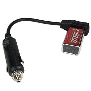

Elfenstar 3rd Gear September 16, 2010 Share September 16, 2010 If they have just invest in a simple battery/ memory back-up device , they could have make the OBD specialist job obsolete and save all the extra expenses and probably could have bill you a high service charges due to faster and high quality service. Fast and good but cannot be cheap I used to use this Link to post Share on other sites More sharing options...
Yeobh 4th Gear September 16, 2010 Share September 16, 2010 They will always suggest you take a coffee break at the nearby Hawker centre or coffee shop. Link to post Share on other sites More sharing options...

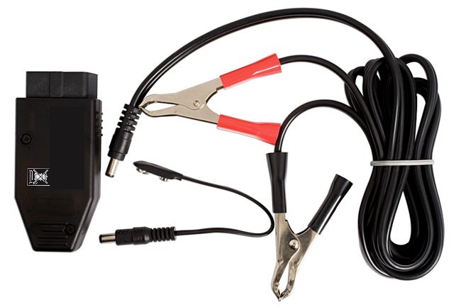

Yeobh 4th Gear September 16, 2010 Share September 16, 2010 (edited) Cheap and good but remember to use a quality 9v dry cell. Base on my experience this unit is good for use in the field when changing battery and always make sure to keep yr rid doors close and reading and glove box light off. PS This is the latest in the market, the unit plug directly into the 9 pin OBD2 socket. You can powered the unit with 9V or 12volt spare motorcycle battery. Edited September 16, 2010 by Yeobh Link to post Share on other sites More sharing options...
Elfenstar 3rd Gear September 16, 2010 Share September 16, 2010 They will always suggest you take a coffee break at the nearby Hawker centre or coffee shop. Thats why you should ta bao some for them before you come. So everyone will have kopi with them Link to post Share on other sites More sharing options...
Elfenstar 3rd Gear September 16, 2010 Share September 16, 2010 Cheap and good but remember to use a quality 9v dry cell. Base on my experience this unit is good for use in the field when changing battery and always make sure to keep yr rid doors close and reading and glove box light off. PS This is the latest in the market, the unit plug directly into the 9 pin OBD2 socket. You can powered the unit with 9V or 12volt spare motorcycle battery. Ooo... I like this Link to post Share on other sites More sharing options...
