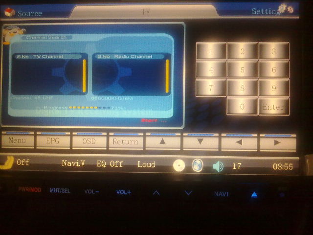

Lester Neutral Newbie August 20, 2010 Share August 20, 2010 Hi all I have got a 2 din head unit from China and it has DVB-T built in. However, I am unable to get any channels after scanning. What am I missing? What is the frequency that I need to scan to? What is the Start and End Frequency? What is the Bandwidth to use (6M, 7M or 8M)? The Hardware version is DVR-TV1.1, Software Version is Sunplus_Box_TV1.20, F/W version 432_032_136_1023_290, Checksum 213794f2, Build date: 23/11/09. Any advise? Thank you. ↡ Advertisement Link to post Share on other sites More sharing options...

Krazz77 Neutral Newbie August 21, 2010 Share August 21, 2010 On 8/20/2010 at 10:04 AM, Ben5266 said: Last time on our bus, the mobile tv is using DVB-T. But now, already cease operation. So, no DVB-T broadcast in Singapore now. Not exactly correct .. there is still digital 5, 8 and CNA . These are at 538Mhz. There's also the HD5 at 610Mhz. I'm receiving these signals on my carpc via a dvb-t usb stick. So, the channels are still there. Try to search for the channels at the frequency range. What i know is i can't receive in kallang/geylang area. In bukit panjang, signal strength is pretty good. Link to post Share on other sites More sharing options...
