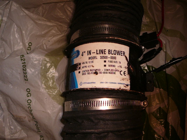

5936 1st Gear August 11, 2010 Share August 11, 2010 Vacuum cleaner sounds possible. Can it run non stop for they way we drive, say 1-2 hours under hot sun. Next, question is water proofinging. Another question is bulky. There are 12/24 V DC axial fan for marine application which I had used before, very powerful and compact. So much air that my previous 2.0L picnic can only use the 3" model. when I upgraded to a 4" model, engine connect take it-- too much air-- cannot start. Throttle response was faster. Best of all Cheap Now outside. Will take a piture of it when return home. The fan is collecting dust. dun know how it will fit current car? Link to post Share on other sites More sharing options...
5936 1st Gear August 11, 2010 Share August 11, 2010 Cant find 3" fan, only the 4" fan Link to post Share on other sites More sharing options...
Jasonjst 3rd Gear August 11, 2010 Share August 11, 2010 Cant find 3" fan, only the 4" fan Hi where you buy these fan ? what the price ? So only can use 3" right... Thanks rdgs Link to post Share on other sites More sharing options...
5936 1st Gear August 11, 2010 Share August 11, 2010 Made by Jabsco, marine electric pumps and blower co. So can get from Marine supplier. For me I get it from Telok Kurau, few shops away from the famous Beach Road Prawn Noodle. At around $30-40. (few years ago price). ducting and stainless steel clamps from Kelantan lane, another $20-30. I use inconjuction with a washable air filter ( going to be dirty faster than the rest). and installed before the air filter, in case fan damaged, parts will be stopped by air filter and not fly into engine. Some of my friend did a on off switch so they can choose when to turn it on, http://www.jabsco.co.uk/marine/blowers/140...-12-volt-dc.htm fan sound noisy without ducting. Once ducting installed on both ends, and seated properly, the fan sound is muffled. It is reversible. Dun like can remove, and low cost. But it may not please everybody. This is just to share what my experience. Link to post Share on other sites More sharing options...
