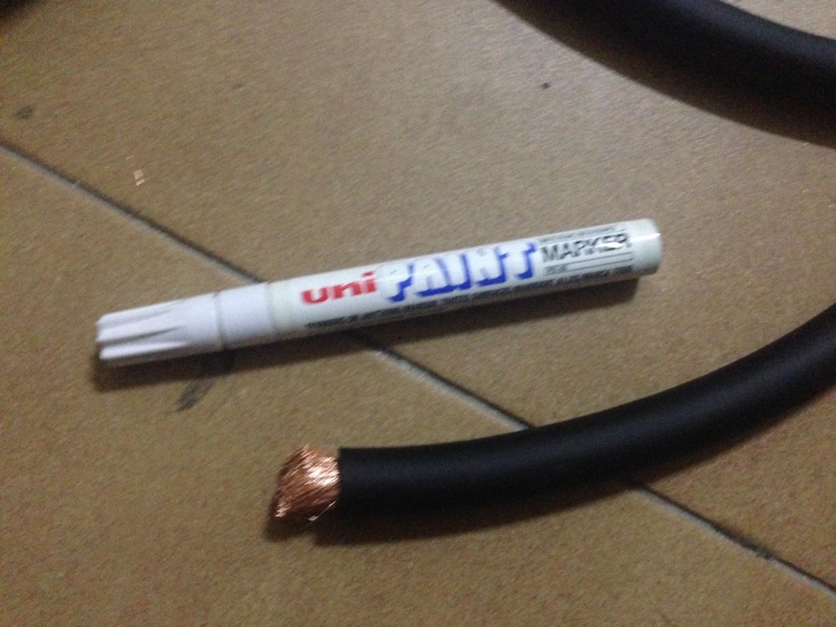

Kurty Supercharged December 27, 2015 Share December 27, 2015 Anyone knows where can I get these copper wire as grounding cable? Recently my old grounding cable worn off, thinking of changing them. Tried to pm p69 but can't. Thanks! 1 Link to post Share on other sites More sharing options...
dcb Turbocharged December 28, 2015 Share December 28, 2015 I think you can still get them from the shops in sim lim tower. On 12/27/2015 at 8:08 AM, Kurty said: Anyone knows where can I get these copper wire as grounding cable?Recently my old grounding cable worn off, thinking of changing them.Tried to pm p69 but can't.Thanks! Link to post Share on other sites More sharing options...
Meemee 5th Gear December 28, 2015 Share December 28, 2015 The grounding cables I m using Awg0 / OFC Car runs smoother Acclecration smoother and better response Idling - steady / no more trembling feel at traffics junction Auto gear shift is smoother It also very skeptical about how grounding cables works Perhaps we should look at the size of the cables You hate it or you don't Link to post Share on other sites More sharing options...
Kurty Supercharged December 28, 2015 Share December 28, 2015 On 12/28/2015 at 1:20 AM, dcb said: I think you can still get them from the shops in sim lim tower.Thanks but which type should I go for? On 12/28/2015 at 1:34 AM, Meemee said: The grounding cables I m using Awg0 / OFC Car runs smoother Acclecration smoother and better response Idling - steady / no more trembling feel at traffics junction Auto gear shift is smoother It also very skeptical about how grounding cables works Perhaps we should look at the size of the cables You hate it or you don't You got spare? Can sell me a couple? Link to post Share on other sites More sharing options...
Meemee 5th Gear December 28, 2015 Share December 28, 2015 On 12/28/2015 at 1:38 AM, Kurty said: Thanks but which type should I go for? You got spare? Can sell me a couple? Have pm you Link to post Share on other sites More sharing options...
dcb Turbocharged December 28, 2015 Share December 28, 2015 On 12/28/2015 at 1:38 AM, Kurty said: Thanks but which type should I go for? You got spare? Can sell me a couple? If I'm don't remember wrongly its 10AWG?! ↡ Advertisement Link to post Share on other sites More sharing options...
