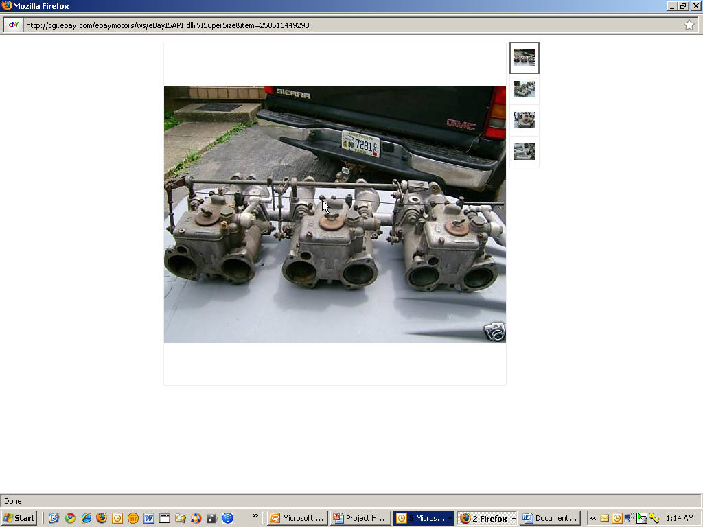

Ididbobe Neutral Newbie October 28, 2009 Share October 28, 2009 Good info here guys. BTW, any preference for Webers DCOE, DCNF or IDF? also is 40 the standard or biggest for the Starlet considering the walls etc? I saw this sweet deal on ebay, chk it out:- Ebay Weber Whaddya think? Link to post Share on other sites More sharing options...
Ididbobe Neutral Newbie October 28, 2009 Share October 28, 2009 Arrghh...just realised that theres 5 mins left for the end of the ebay auction. Unless someone answers this post really fast its gone! :0 Link to post Share on other sites More sharing options...
Ididbobe Neutral Newbie October 28, 2009 Share October 28, 2009 Gone [bigcry] Oh well theres always this:- ↡ Advertisement Link to post Share on other sites More sharing options...
