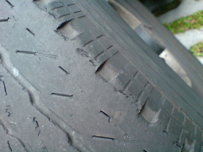

Ev0lutionz Clutched September 16, 2009 Share September 16, 2009 (edited) Last serviced 3 weeks ago and today when i inspect the tyre, saw some metal wires protruding out.. Company van btw. So should trust workshop or my inspection? Edited September 16, 2009 by Ev0lutionz ↡ Advertisement Link to post Share on other sites More sharing options...

Sturtles 6th Gear September 16, 2009 Share September 16, 2009 On 9/16/2009 at 2:19 PM, Ev0lutionz said: Last serviced 3 weeks ago and today when i inspect the tyre, saw some metal wires protruding out.. Company van btw. So should trust workshop or my inspection? The workshop has no responsibility for your safety, and if you truely see the wire reinforcements of the tire, then perhaps you should know know what is the right thing to do Link to post Share on other sites More sharing options...
Ev0lutionz Clutched September 16, 2009 Author Share September 16, 2009 (edited) On 9/16/2009 at 2:25 PM, Sturtles said: The workshop has no responsibility for your safety, and if you truely see the wire reinforcements of the tire, then perhaps you should know know what is the right thing to do Okay.. Tomorrow gonna change liao. No wonder i felt very slippery in the rain. The last service they only change the back tyre. Back tyre new, front tyre nv change. Edited September 16, 2009 by Ev0lutionz Link to post Share on other sites More sharing options...

Amortifiedpenguin Clutched September 16, 2009 Share September 16, 2009 change. which workshop. must black list. once you can see the fibre its is very likely to explode upon stress or a sharp rock. Link to post Share on other sites More sharing options...
Kyojin 1st Gear September 16, 2009 Share September 16, 2009 On 9/16/2009 at 2:19 PM, Ev0lutionz said: Last serviced 3 weeks ago and today when i inspect the tyre, saw some metal wires protruding out.. Company van btw. So should trust workshop or my inspection? did you buy the tyres new? or are they regrooved? if they were bought new without regrooving, see how much thread is left. there should be more than 2mm depth. if less than this, you definitely need to change. if they were regrooved before, you should immediately change. light goods and passenger tyres should never be regrooved Link to post Share on other sites More sharing options...

Nhrisuzu 1st Gear September 16, 2009 Share September 16, 2009 those are the steel-belt.. common to have on commercial vehicle tires.. actually, even before u see the wires u should change liao.. the moment u see the tires start to appear rounded near the contact area.. it is time to change already.. cos behind that curved area is the steel-belt.. Link to post Share on other sites More sharing options...

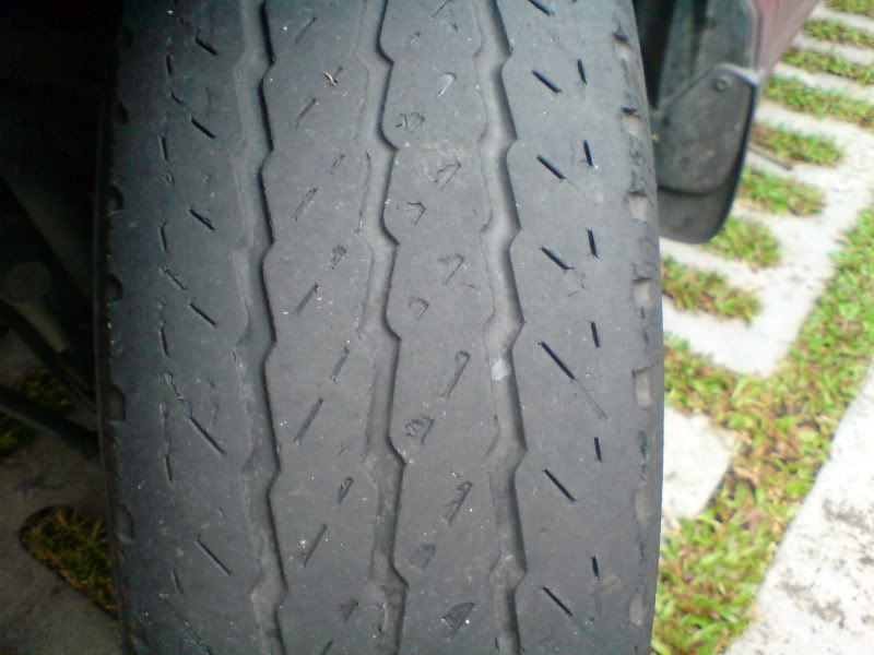

Ev0lutionz Clutched September 17, 2009 Author Share September 17, 2009 Today just changed new one already. These are the old ones. Link to post Share on other sites More sharing options...

Archenemy 1st Gear September 22, 2009 Share September 22, 2009 im from the tyre industry.. once the steel belts are visible, the tyre has to be changed. the steel belts are the thing holding the tyre together, once exposed, water can seep in between the rubber and steel wires, weakening the tyre further.. and from what i see, your vehicle has slight alignment problems..do get it rectified also.. my 2 cents.. Link to post Share on other sites More sharing options...

Gadgeter 2nd Gear September 22, 2009 Share September 22, 2009 On 9/17/2009 at 1:04 PM, Ev0lutionz said: Today just changed new one already. These are the old ones. Luckily you have changed the tires... the old one look bad.... Link to post Share on other sites More sharing options...
Altivo 3rd Gear September 22, 2009 Share September 22, 2009 wah... gonna botak leow. the wear and tear is kinda uneven huh... can see from the second pic ↡ Advertisement Link to post Share on other sites More sharing options...
