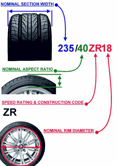

Benji Neutral Newbie May 2, 2006 Share May 2, 2006 guys, just wanna ask about the nomenclature used in tyres... eg: 185 60 / R14 wat does ea individual number represent? pls enlighten me. thanx!!! ↡ Advertisement Link to post Share on other sites More sharing options...
Tribeca Neutral Newbie May 2, 2006 Share May 2, 2006 yoi bro, a picture paints a thousand words Link to post Share on other sites More sharing options...
Shull Turbocharged May 2, 2006 Share May 2, 2006 (edited) please note that aspect ratio aka profile and section width is in mm while radius is in inches.. Edited May 2, 2006 by Shull Link to post Share on other sites More sharing options...
